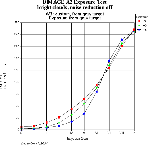

The following set of contrast curves relates to the image on the right above. Underexposure is revealed by the fact that the right half of the curve is steep and pixel saturation isn't quite reached, and the left half of the curve is long and shallow. The image intensity represented by the red dot on the Zone V line is taken from the upper left dark region of the target, the red dot on the Zone VI line is taken from the upper right lighter region of the target.
The camera's histogram at the moment of exposure indicated slight underexposure, as the intensity peak for both halves of the target were below the midpoint of the graph. But the photographer had a short time before taken careful readings, and the idea that the manner of taking the exposure reading may have been improper or that the light may have changed did not at that moment well up to the top of his consciousness. Even less was he prepared to think that the exposure algorithm favors underexposure.

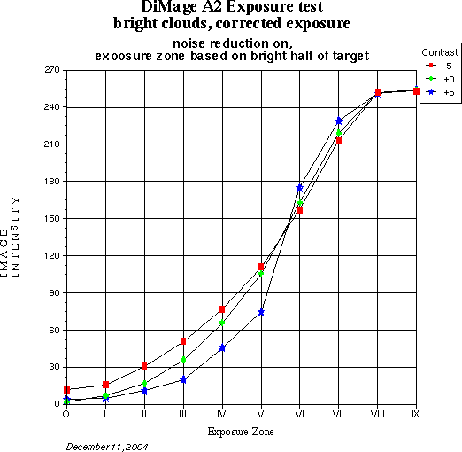

These two series of exposures also compare "noise-reduction ON" with "noise-reduction OFF". It is wonderful to see that there's no increase of image intensity in the darkest values at this ISO -- no detectable noise.
But this set of curves is obtained by taking the exposure reading from a middle-gray target (the dark half of my target board) and taking image-brightness measurements from the image of the bright half of the target, which is almost exactly one stop brighter than the dark part of the board.

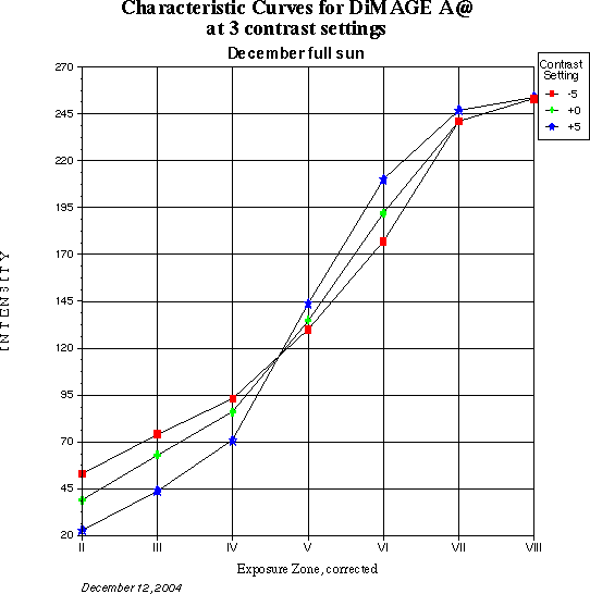

First, compare a correctly exposed image (left or top) with an overexposed image (right or bottom) taken in sunlight that (based on the metering) was expected to be equivalent:
The upper left dark area of the target is represented in the characteristic curves below by the red dot in the Zone V vertical line.
Remember, the "Exposure Zone" is the placement intended by the exposure reading, not the resulting image intensity.
This result woke me up to the possibility that the camera's exposure algorithm or metering function may be unreliable, as I was particularly meticulous, setting the camera to use spot metering and carefully taking the reading from the dark side of my target.
In fact, this is still a half-stop overexposed compared with the standard:
